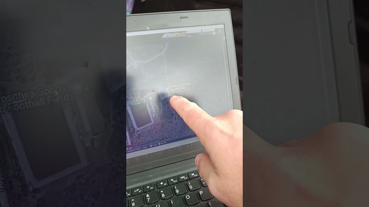

Yesterday i went out testing again and even though i flew with both GPS units ON, at some point i got the same issue. https://youtube.com/shorts/t_MLGX_bjZM
Right after i got the Issue i disabled the Here4 and the CAN drivers and it all went back to normal.

New Here4 unit installed and since today it was not raining I decided to test how it works.
Same issue! Solution was to disable the Here4.
It’s a pretty lengthy video but it shows what the new unit issue was.
My guess so far is that the here4 for some reason doesn’t like to play along the um 982
