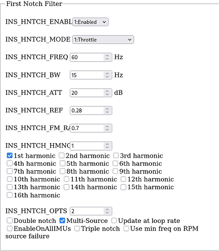

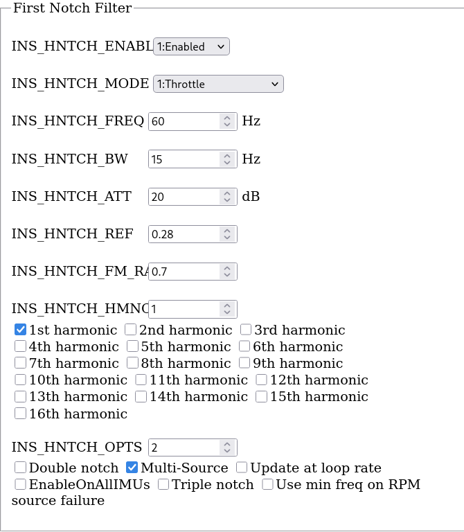

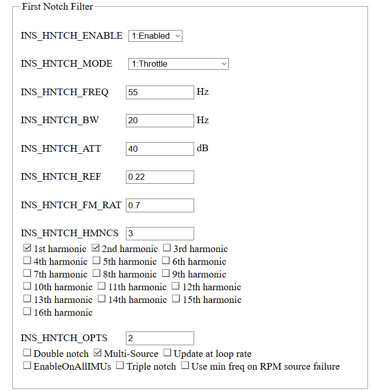

If for some reason you really want to run a harmonic notch filter use these settings pictured below, however I think it will cause more instability than it solves in your case.
The only real advantage I can think of is: if you add a payload and it enhances vibration well above current levels.

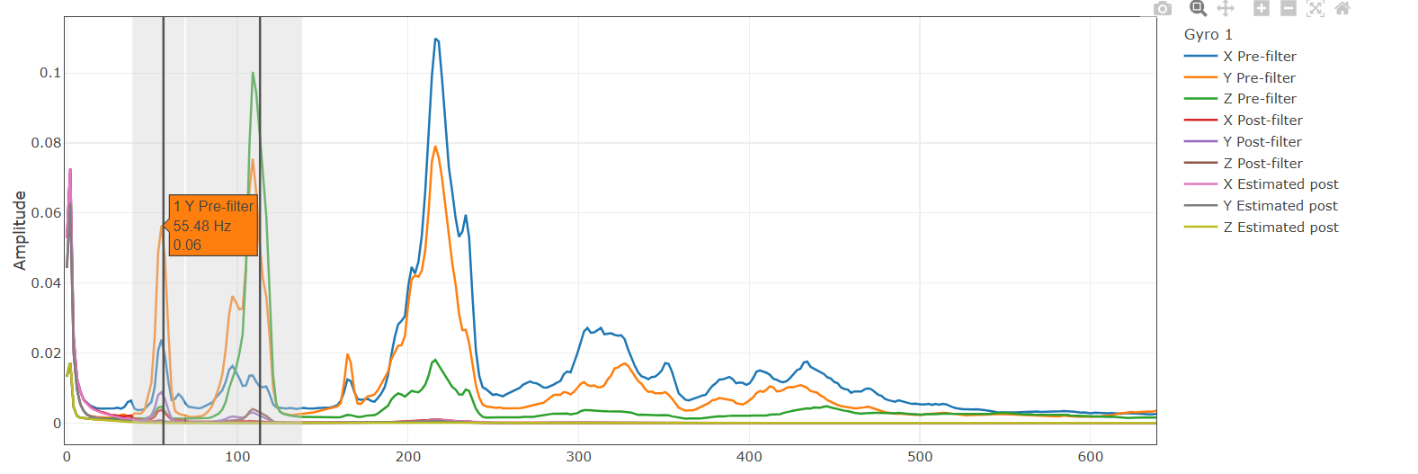

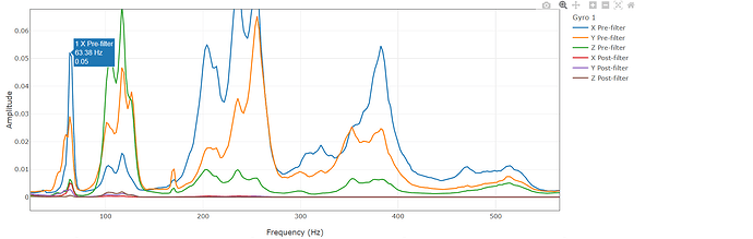

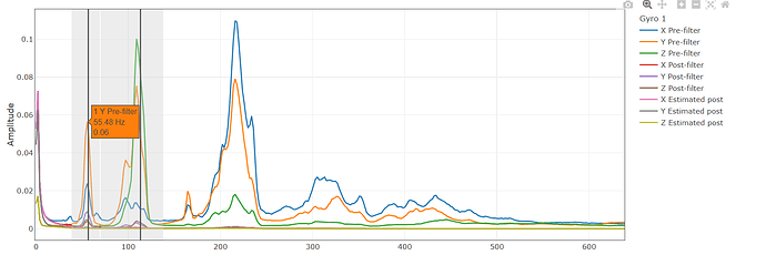

Hi @xfacta ,

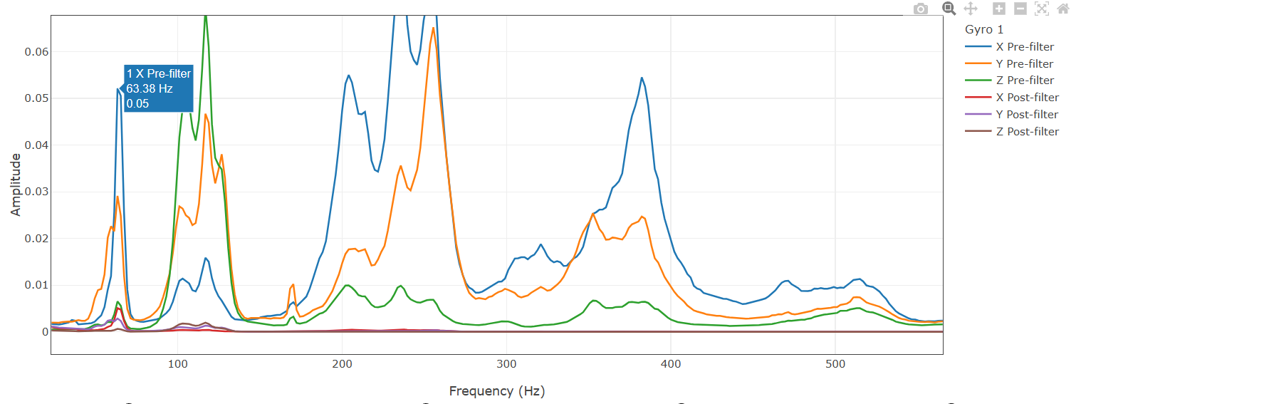

I have following Query regarding notch filter..!
Observation:
  • A noise peak is observed at 63 Hz, which appears to be associated with the motor.
  • Following the 63 Hz peak, four additional consecutive noise spikes are also observed.
Query:
No, in your case the post-filter noise is almost nothing.
The values I provided will fix this, although the post-filter noise from the primary peak is still almost negligable and not worth worrying about.
You could always do anything you want, but an FFT-based notch filter will be broad and overly aggressive, like hitting a thumb-tac with a 10-tonne hammer.
Always fall back to checking the post-filter noise, that’s what matters. You can see it’s practically a flat line across the bottom of the graph. Any bumps are below -50db so not worth introducing other issues to fix them.
Focus on the next steps I gave and dont worry about something that is not a real problem.
Hi @xfacta ,
As per your previous recommendation i have performed flight , there is a small update. This test was conducted using the same drone, but the flight was performed without the camera installed.
I observed a slight shift in the notch filter frequency from 60 Hz to around 55 Hz.

This can happen when MOT_SPIN_ARM and MOT_SPIN_MIN are not set correctly. These are affected by changing the thrust expo, and conversely they can affect the thrust expo.
I maintain that you DO NOT even need a harmonic notch filter, or MAYBE with the settings I provided with the adjusted lower frequency. The post-filter noise (after INS_GYRO_FILTER) is already so low that having any harmonic notch filter introduces other issues like phase lag that will affect subsequent tuning.

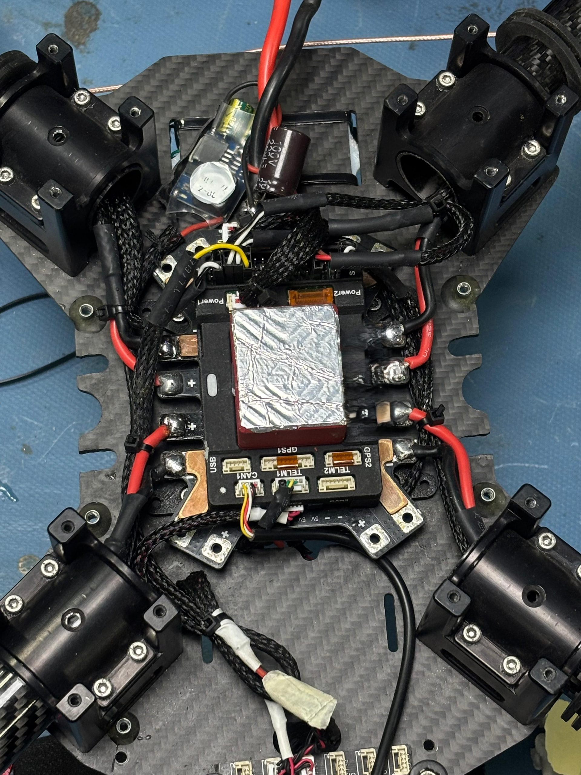

Even though noise is not getting past the gyro filter, there is significant vibrations with a small amount of clipping events. Try to find anything loose or touching the flight controller and secure it. Wiring connected to the FC should not be pulled tight, allow enough freedom that the wires dont transfer vibrations, but not so loose they flap around all over.
Maybe send a photo of the flight controller and wiring.
Hi @xfacta ,
I do not see any moving parts in the flight controller assembly. The flight controller (FC) is directly screwed on top of the PDB. Please refer to the attached image.

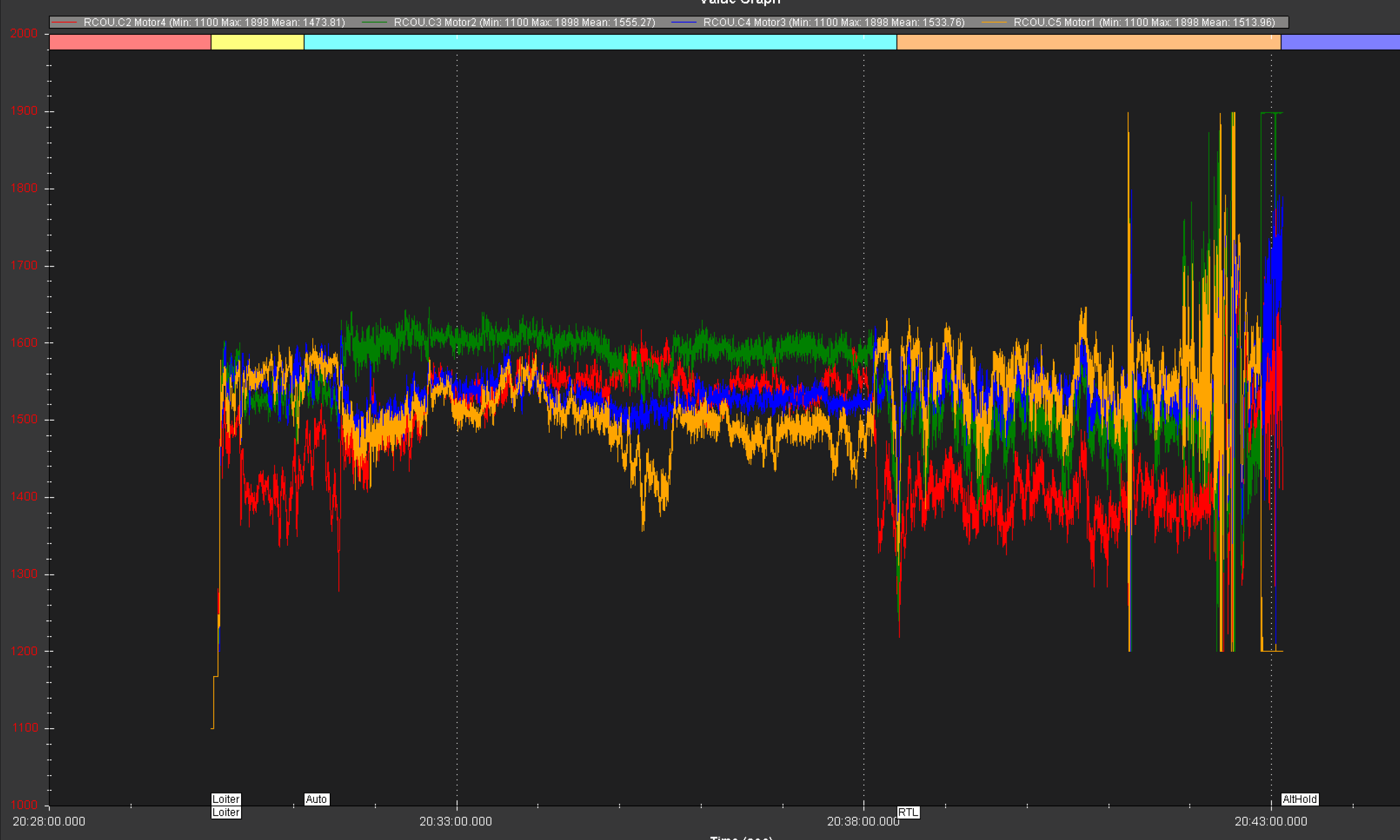

In the subsequent flight, I executed an Auto mission for 3 km. While flying outbound, the performance was normal. However, during the return leg, at approximately 1 km from the home point, the drone began to oscillate aggressively, which ultimately led to a crash.
Could you please help analyze and identify the possible cause of this crash?
Please find the attachment: Flight log.
Thanks.
Good news
Attitude control is great - everything we did worked. Right up until the crash :frowning:
Bad news

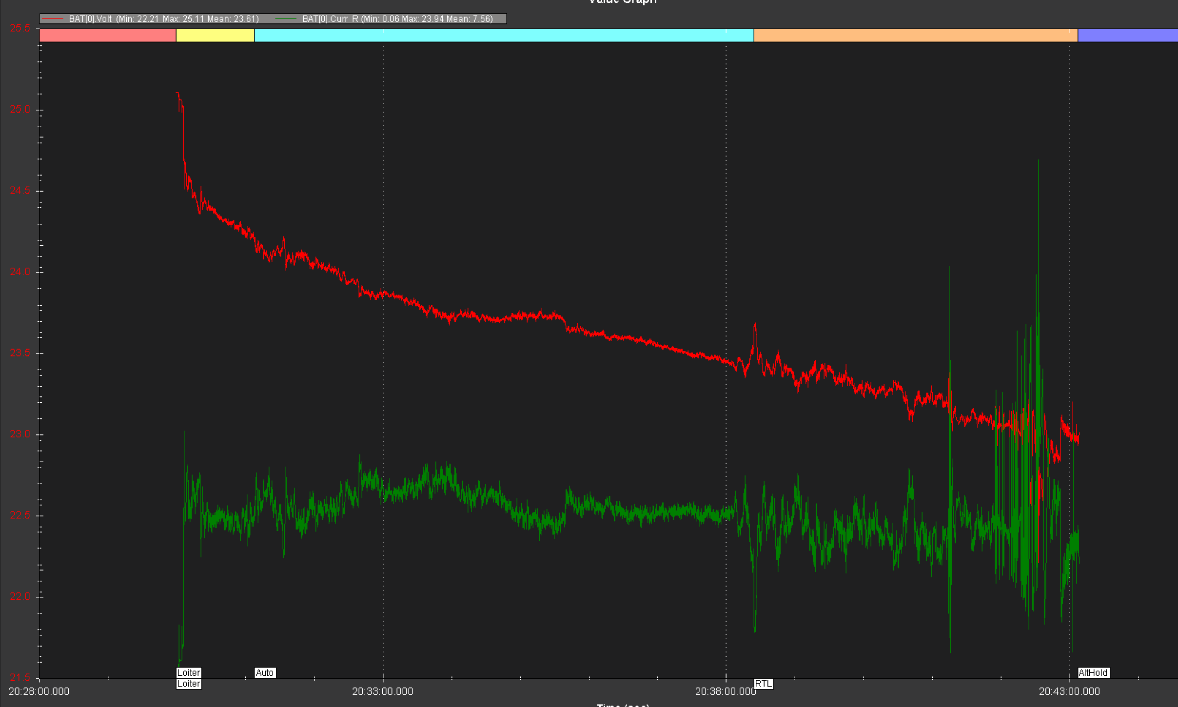

Just looking at battery voltage and current we can see the outward bound journey is smooth, probably with the wind. The return journey is tougher, probably because of wind. There is one noticeable spike in current, then a short time later the trouble starts.
Looking at motor outputs we can see the same overall picture as we did with the battery details.

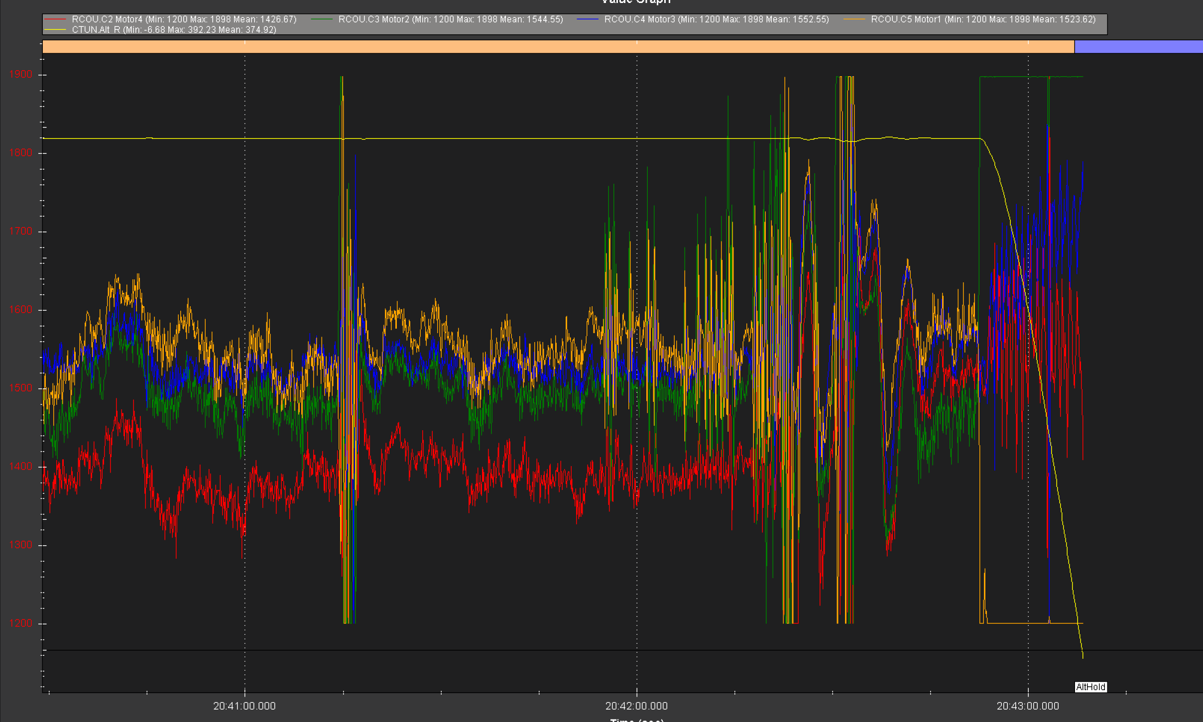

Looking closer at the motor outputs (and altitude) we can see Motor2 and Motor1 were involved in all the incidents. The copter struggles through and Motors2 and 1 recover and continue working until finally Motor2 stops providing any thrust and is commanded to maximum, Motor1 is commanded to minimum to compensate - being a quad there is no redundancy and the copter goes down.
When those motor outputs are commanded to maximum, that means the motor or prop or ESC has stopped providing thrust. If it was just one motor you might expect a motor mounting screw touching one of the motor windings causing a short or something like that. When it’s two motors/ESCs playing up at exactly the same time you’ve got to look to the common elements, like the brand and model of ESC for example. Or is there power wiring common to just those two ESCs?
