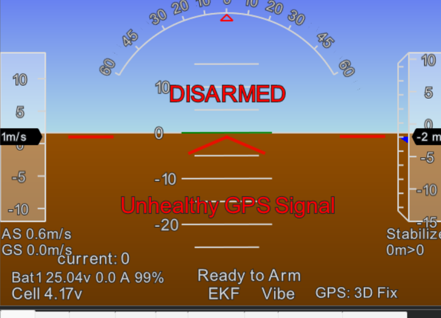

Seen this on several topic already but never seem to see an actual solution.
I have Cube Orange + (version 4.5.7)

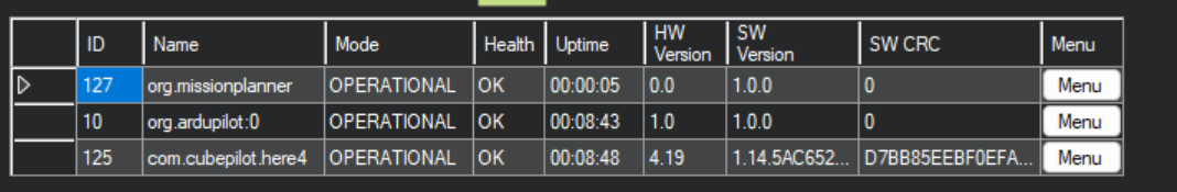

Here4 GPS - also update to the latest (HW version 4.19 / SW version 1.14.5AC6523C ).
I seem to have all configured right, I get 32 sats and 0.5 hdop with 3dfix.
I keen on getting either gps1 unhealthy (arming denied) or “unhealthy gps”.
Steps taken to eliminate the issue:
Reinstalled Arducopter
Recalibrated compass /accl /etc…
Replaced Cobe Orange.
Any support will be appreciated.
Thanks.

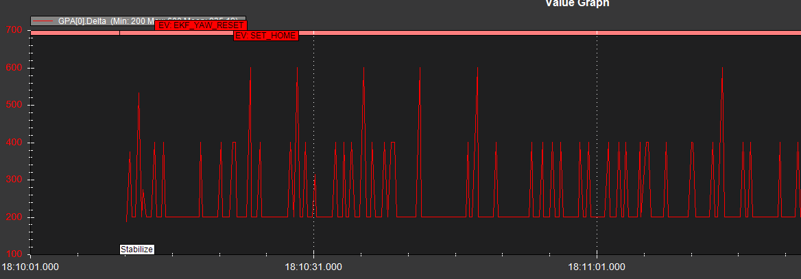

Number of Sats and HDOP is OK, but the update rate is poor.
This should be a straight line across at 200ms (5Hz)
There’s also a bunch of config errors is the messages, like these:
You should try the update process in the manual at section 3 to see if it helps with the config errors.

Update Rate - What is the cause for that issue ? (we have lowered the constellations to only GPS/Galileo)
Erros - Gps is updated as seen in my first message in the thread.
