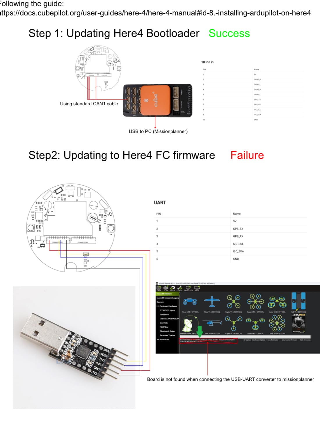

I wan’t to test out using the Here4 as an autopilot for a rover.
Everything was going smoothly, following the guide online until “Step2” https://docs.cubepilot.org/user-guides/here-4/here-4-manual#step2-updating-to-here4-fc-firmware
I get as far as:
  • Search parameter FLASH_BOOTLOADER , set the parameter to 1
  • Then click Refresh Params, check if the parameter auto resetted to 0, confirming successful update.
The parameter auto resets - great!

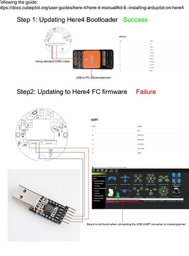

I unplug the Here4 from the CubeOrange, open it and connect the full “connector 1” cable that was included to the break-out board and connect it to my serial to USB converter, but it does not show up on the “Install firmware” page in mission planner. The Here4 has lights on, in rainbow disco mode…

Hello, maybe you have connected the TX and RX to check
This is my setup :slight_smile:
changed the TX and RX maybe an error in the USB
I get the same thing. I am not sure what the problem is .
