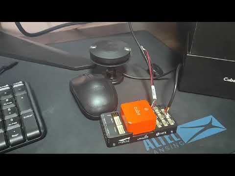

Thank you for your response, I actually inherited the project from a friend who could not finish, he is no longer with us and cannot give me information about what he had worked on with the orange cube, I checked the memory and I see that he has the firewall installed, Here is a video of what it does when you connect it.
