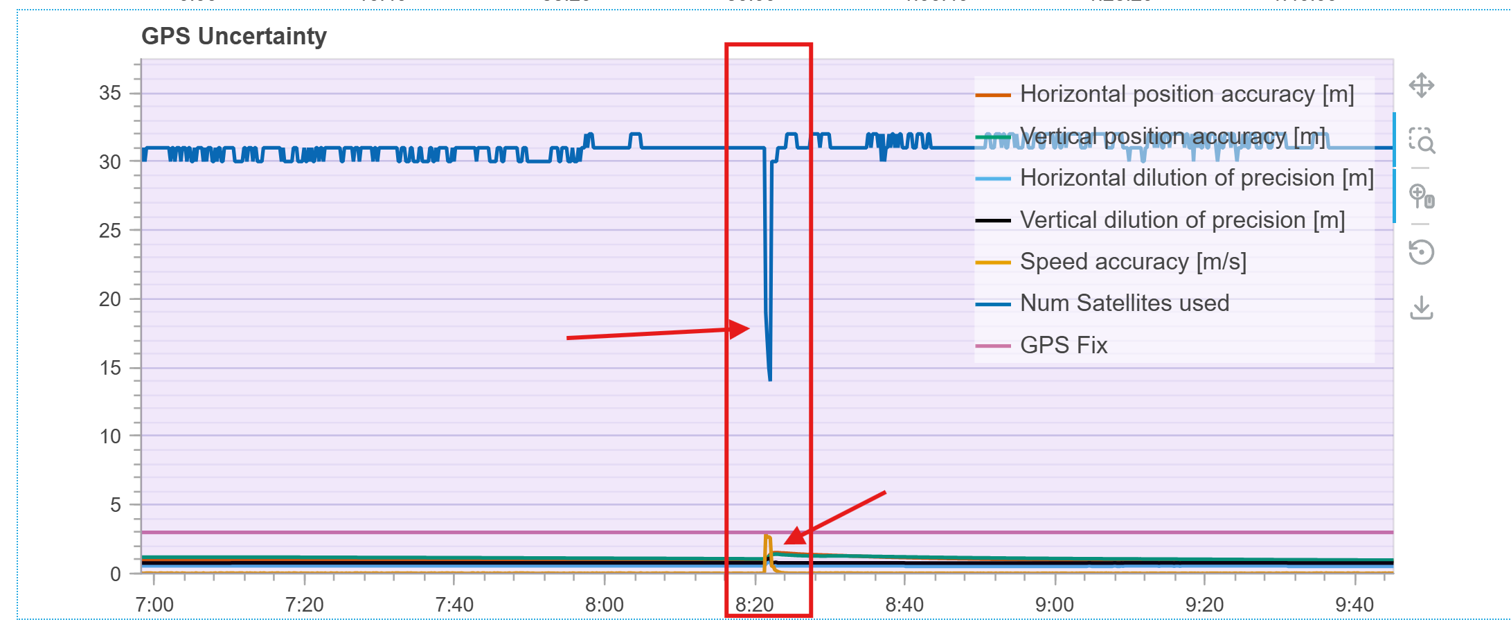

GPS Drops in Satellites at 4:12 elapsed time
We are investigating an intermittent “GPS glitch or compass error” issue.
Observed behavior:
  • Satellite count drops sharply during the event
  • HDOP increases during the same time window
  • Horizontal, vertical, and speed accuracy increase
The event lasts approximately ~0.5–1 second.
Timing:
  • The event consistently occurs at approximately 254–255 seconds after boot (~4:12 elapsed time)
  • This timing has been repeatable across multiple flights
  • It occurs regardless of flight mode
  • It also occurs during ground testing with motors off after the same elapsed time
System configuration:
  • Cube Orange+
  • Here 4 Blue
  • Herelink Airunit 1.0
The “GPS Glitch or compass error” message does not announce at each of these events, but these same indicators have occurred each time.
