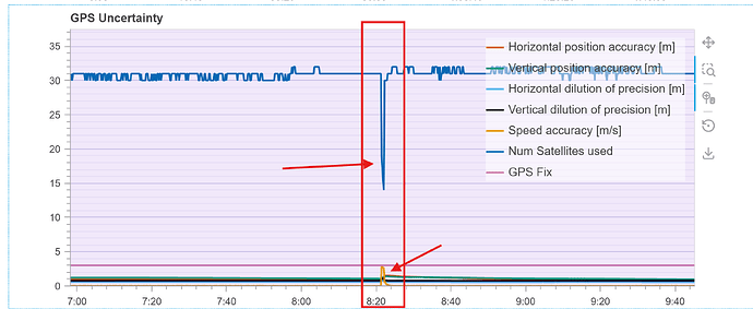

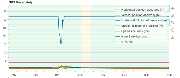

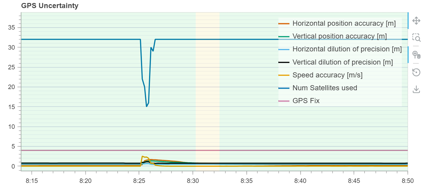

Approximately 8:20minutes after system power-up, the Here4 loses about half of its satellites for a second or less. As a result, the position becomes too inaccurate, and depending on the configuration, the system switches to failsafe land mode or drops out of position modes like Position (Px4) and back to, for example, Althold. After this single dropout occurs, it does not happen again. I was able to continue a test flight for about 30 minutes after this dropout without further problems.
This dropout can also be observed while on the ground. In fact, any flight controller with a connected Here4 module is sufficient to reproduce this error. It happens consistently, regardless of the flight controller hardware (in our tests, CubeOrange and Holybro 6x) or the time of day (satellite position).

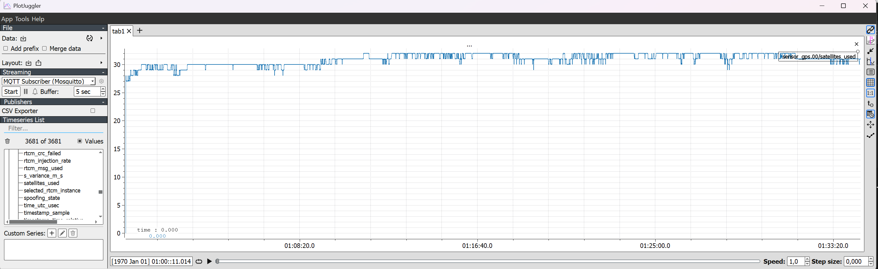

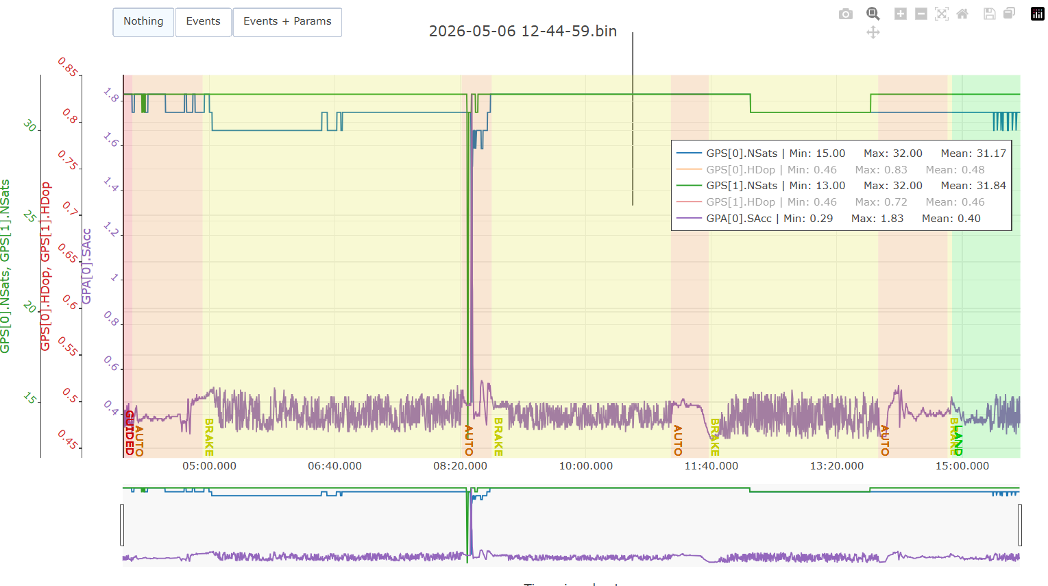

Dataplot Image:

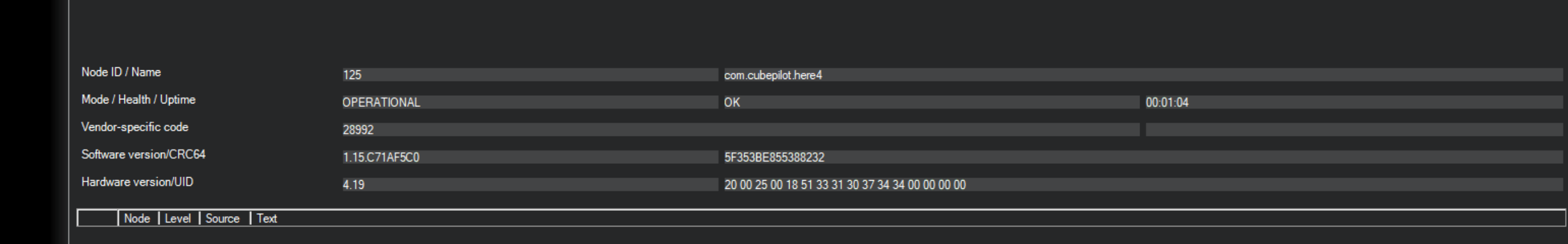

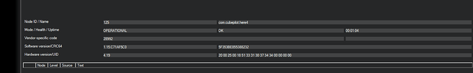

Also the firmware version on the here 4, just so we know where to start looking

Here is the FW-Version of the Here4. It should be the newest:

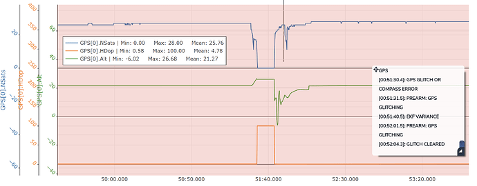

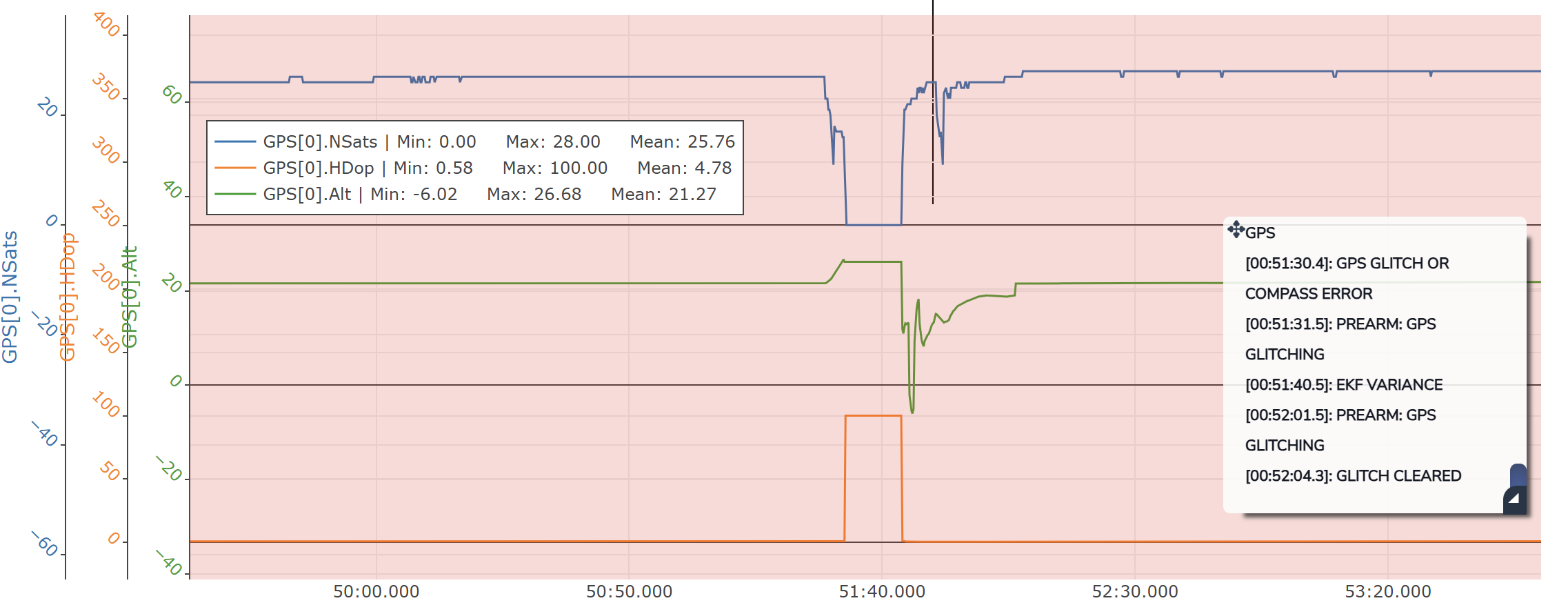

  • I’ve attached a preview of our logs showing the instantaneous satellite drop and EKF variance.
This is a professional-grade module, but right now it’s performing like a liability. We need an official word from the developers—is this a known batch issue or a fundamental flaw in the current firmware’s GNSS processing?
Over 50% of our fleet is experiencing the glitch some after 9 min, the example below is at 51 as you can see so we cant predict it

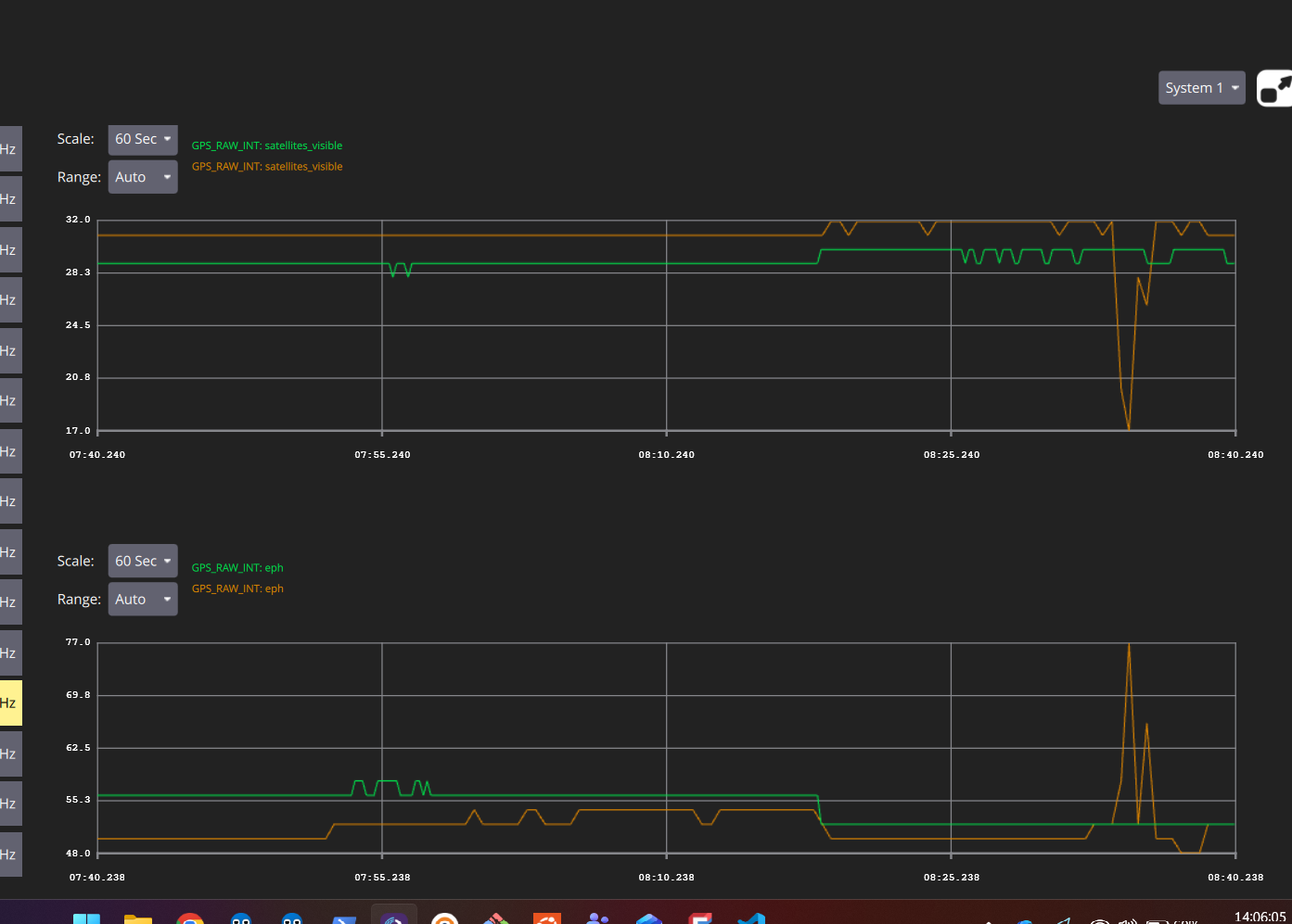

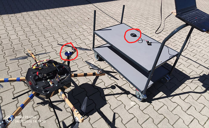

1. Today I conducted a few more tests. Specifically, I equipped a Holybro 6X FC with a Here4 CANbus GNSS module, and set up a second system with a Holybro 6X and a Holybro DroneCan F9P. First off, with the Holybro DroneCan F9P, I didn’t experience any dropouts—as described in this thread—during any of my test runs today. The longest log file with the Holybro DroneCan F9P is about 33 minutes long and has no dropouts.
In the comparison test, both systems were started simultaneously. The Here4 dropped out after ~8 minutes, while the DroneCan F9P continued running at the same time. ( In Image Orange, the System with Here4, Gren the system with Holybro Droncan F9P)

Looking at the plots, the most important point seems to be the repeatability of the event around the ~8:20 mark after startup. The satellite count drops very sharply for a short period, HDOP/accuracy spikes at the same time, and then the system recovers and remains stable afterwards.
Because it happens on the ground, across different flight controllers, and apparently only once after startup, it does not look like typical random RF interference or normal antenna placement behavior. It feels more like a receiver-side state transition, firmware timing event, ephemeris/constellation update process, or communication/output congestion during initialization.

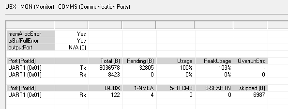

One screenshot that caught my attention is the UBX MON-COMMS view showing UART TX usage at 100% with peak usage above 100%. If many raw/debug messages are enabled, it may be worth testing with a reduced UBX output message set to see whether the dropout changes or disappears.

I too have experienced the exact same issues on Here4, and have done a lot of testing on the ground to confirm that it’s happening consistently and independently of other interference sources such as RF and high power.
At first I saw it happening on my drone, so I thought maybe it was radio or ethernet interference knocking out the GPS momentarily. But after investigating prior logs, I saw that it was definitely not that issue, and definitely not “random”.

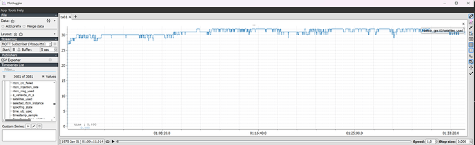

In nearly all of the logs collected the issue is happening around the 8.2 minute mark. A transient drop of sat count typically from around 30 down to 12 or 13. In some cases, the EKF handles it fine, but in others, GPS is rejected for a few seconds and the drone does a toilet bowl.
I did some tests with ONLY a carrier board, a cube, and a Here4 GPS, powered by only USB - no radios, no high current, no switching regulators, etc. The issue still happens nearly 100% of the time, at either ~4 minutes or around 8.2 minutes.
The tests were done with the latest Here4 firmware, and no other settings have been modified, aside from the CAN node ID.
I also did an extended test (>30 minutes) to see if it would reoccur, but it does seem, as others have reported, that it only happens once in a power cycle. Here’s a log from the event happening around 4 minutes:
