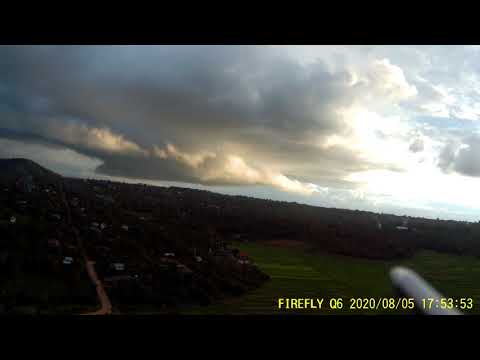

Just received my Q6 camera and test with herelink. It worked right with all stock setting. Light weight and compact, it’s better than split 4k in many aspects!
