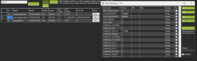

The GPS units appear as garbled messages using SLCAN direct (image shown below of parameters)
No solution has been found to interface with the GPS units once FDCan is turned on

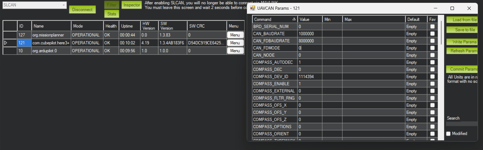

The image included above was taken from the DroneCAN gui tool, that is what it looks like when it connects.
After working with Michael Oborne, I updated to a new beta version of Mission planner, and there was a small change that allowed me to connect to the FD enabled GPS units. I was then able to change the Here3+ GPS back to normal CAN.

The parameter is CAN_D1_UC_OPTION
Then you have to use SLCAN to connect to the GPS and change its parameter back
