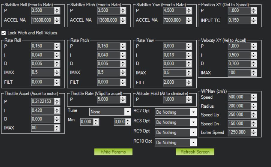

Here is our PID settings so far :slight_smile: , Any comments or advices are welcome.

Couple of things from looking over the log:
  • Your Z-axis vibrations are quite high, they regularly exceed 30 m/s/s which will cause problems. The clip parameter tells you how many times you hit the limits of the accelerometer (see documentation here). You hit almost 5000 clips during the flight, whereas an acceptable level is <100:
Look to see if there’s anything loose on the frame or if there’s anything flapping around near the flight controller. If everything else looks secure, you may need to use a vibration dampener. I had a similar issue and had to use a vibration dampener to get Z-axis vibrations down significantly.
*Your PIDs are quite low. This is clear in your log as desired and actual pitch/roll have significant deviations:
We have a Gryphon 1400 frame and our PIDs are quite a bit higher, with stabilise P around 6 for both roll and pitch and rate roll/pitch P around 0.21. Our tune is not perfect, still needs a bit of work but it flies okay-ish. We need to put it through another round of autotune to try and get it locked in.
I would recommend doing some more manual tuning and reducing the Z-axis vibration down to an acceptable level before attempting an autotune, otherwise you might get less than satisfactory results.
Hope this helps
Thank you very much, it does help a lot and confirm what we were thinking about our PIDs. (Without really understand where to start)

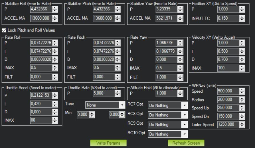

We made an autotune flight today ! Perfect weather, no wind, no extra heat, no rain… Just a lot of fun watching the big bird tuning itself !
New PID :slight_smile:
It flies really well in Stabalize and AltHold, it feels reactive and stable.
However, the Loiter flight mode gives us some worries. No toilet bowl effect, solid position hold but flies less stable. It’s like its stands on a pole on its center point. It is balance really well but unstable, He is wiggling all the time.
