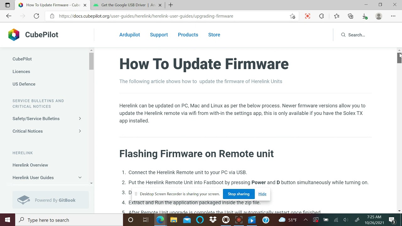

Gone to the site downloaded the “Google GPS Driver” then proceeded to download “Flasher_win” and open the file so that I can make a shortcut to my desktop. I then connect the lipo battery to the “Air Unit” and plug in the ubs cable to computer. It dings and says there is a error with something on the ‘Air Unit’ then ding seconds later saying its ready so I click the “Flasher_win” icon and it gives me a warning and I run it anyways and it pops up for literally a few seconds saying looking for device and connects to something because it shows a quick glimpse of some files running but immediately disappears, Then nothing…
I even tried extracting the files of “Flasher_win” and doing the steps all over.
Could anyone please explain in detail what you did from the point of downloading the “Flasher_win” & “Google GPS Driver” to get it to follow thru with the update, I’m not the best with technical terms so breaking it down as best as possible really helps

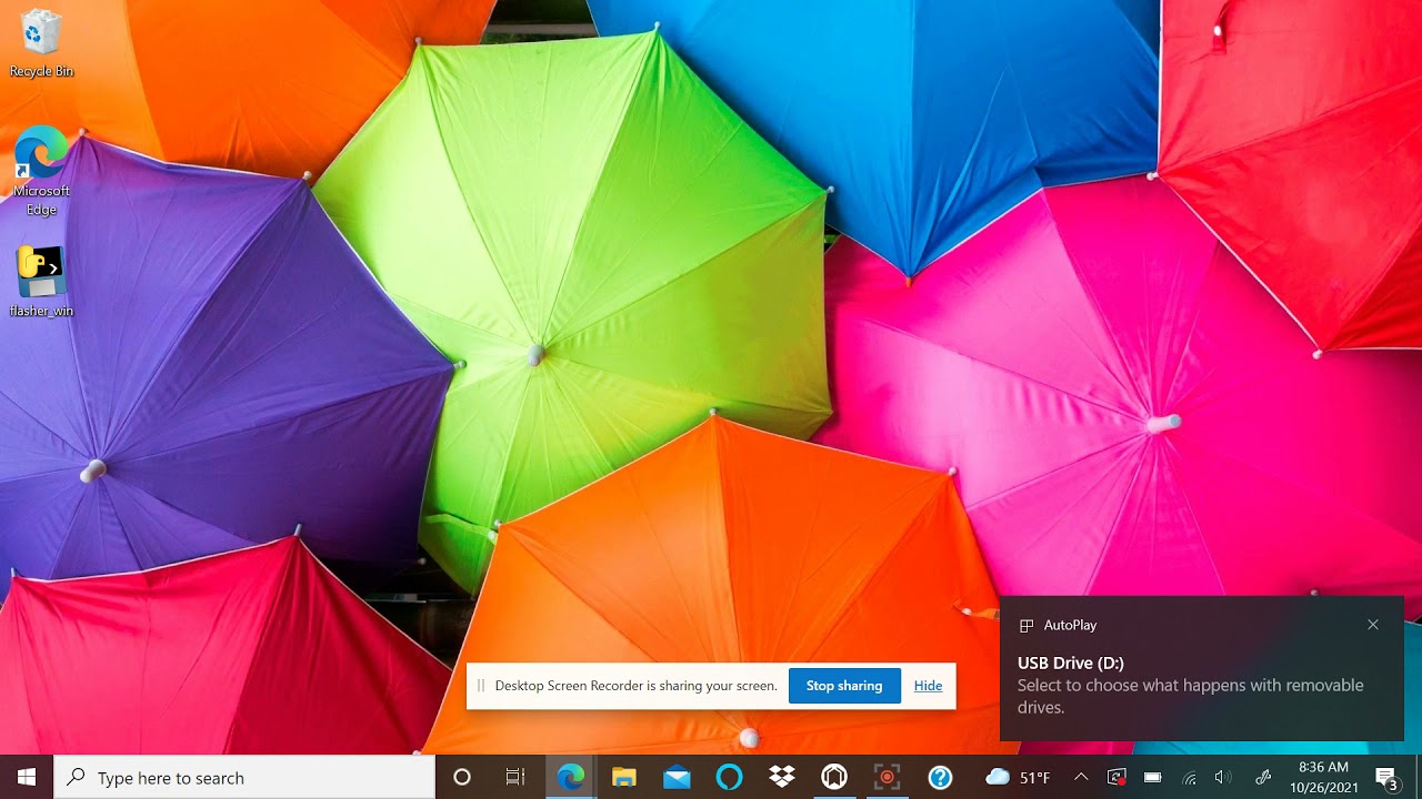

This black box is what pops up for only a very brief 1 sec when trying to flash the air unit before it crashes quickly…
I’ve also included 2 videos below of exactly everything I’m doing step by step, so please let me know what I’m doing wrong or anything else I need to be trying
Screenshot_20211026-093136
Might be related to Google driver not being correctly installed.
You may try this:

You can have a look at this. There are some pictures so you can follow with
